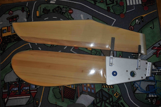

In Canada the combination of the Milanes rudder blade and the RWO rudder stock is very common and proven. Barney has a nice system where in addition to tightening the wing-nut when the rudder is down, the downhaul has a triple length of shockcord in the line. This allows the rudder to pop up if it grounds, but has enough strength that it never lifts when sailing.
In the photo you have the Milanes elliptical lifting rudder with the RWO stock and a fixed version of the standard Milanes high aspect rudder that is popular in the UK.
