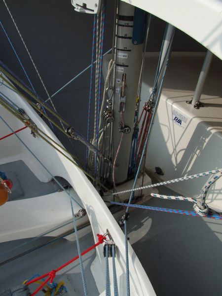

Photo below of the bottom of my mast (before I re-rigged it).
This is how most of the Speeds were rigged, although yours looks quite a bit earlier.
www.albacore.org.uk/alb/media/kunena/att.../ALB8126Shrouds2.jpg
As the luff length of the jib can vary significantly with different sails, there is no single jib halyard length. There are different schools of thought on the correct rig tension, with an older Speed, I wouldnt go for too much rig tension - as a guide the leeward shroud should be only just swinging in the breeze.

I've studied your picture and added labels as to what I think each control is based on the layout of my boat. The is one line I can't make out though, the white line just behind the mast. Any thoughts?
i272.photobucket.com/albums/jj197/rb_str...rols_zps07fc66d9.jpg

The white line is in fact the cunningham. The blue line you have labelled cunningham is the clew outhaul lead to the side decks.
You missed the pre-bend (ie mast strut up) next to the ram (mast strut down).

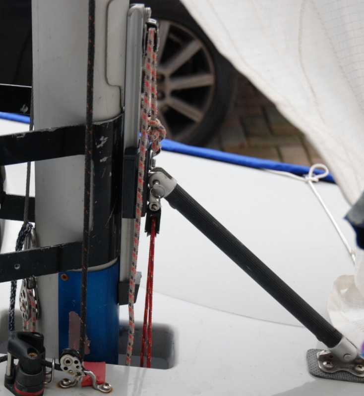

I definitely do need to work on the rigging controls. The worst offenders seem to be the pre-bend and ram controls. I have 4 to 1 and 8 to 1 respectively, with relatively straightforward control leads. The strut track seems to be reasonably smooth, so not sure why I need to pull extremely hard for anything to move. One possible reason is that the strut is quite short (only 25cm). What kind of purchase do people have on their pre-bend and ram? Should I increase the purchase power or look elsewhere to solve the problem?

I've got a Selden mast. I'll try and check which specific Selden mast it is when I next go down.
I'll also measure the strut as I think it may even be less than 25cm (photo attached and before you ask, I have changed the control lines to something more suitable).
I suspect a combination of short strut with steep angle and insufficient purchase are the problem.

Are you trying to pull strut with rig tension on, try putting pre bend on before tightening jib halyard.
Not having used pre-bend on a strut before, maybe I'm misunderstanding the purpose.
My assumption is that the pre-bend is used when you want a flatter sail, but without the leech tension (a kicker gives you the bend, but with loads of leech tension as well). I can see this being required in very light winds and very heavy winds when beating upwind. Downwind you would want the fullness back (and I read it does allow you to square the boom more) which would mean that pre-bend would be off again. This naturally means you would need the ability to apply pre-bend on the course as and when required which I would assume also means the jib halyard is already tight.
That's the theory, so is that not what happens in practice?
Last edit: by rb_stretch.

You are correct in your analogy, if its not working you may have to look at your spreader settings and mast foot position. I think you have a cumulus, which is quite soft. A good starting point may be set the mast foot as far forward as class rules allow (3350mm). Sight the mast with the spreaders not attached to the shroads. With the mast upright with the jib up, set the spreader about 1" forward and 1" inch out. Then connect shroads to spreader. Your are looking for all the tell tales on the leach of the main flying at the same time in 8 to 10 knots of wind.
