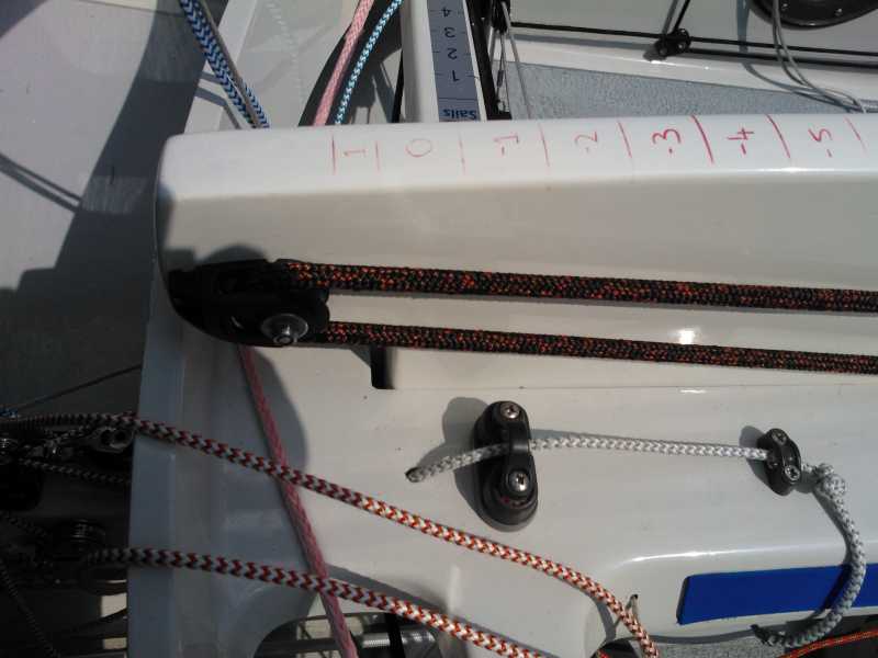

Centre Board Downhaul 12 years 8 months ago #9350
Standard Fireball down-haul, the lower string in the picture starts underneath a hole in c/board case, astern of max down, with a knot on the end, around the block on the board & then off to a take up.
