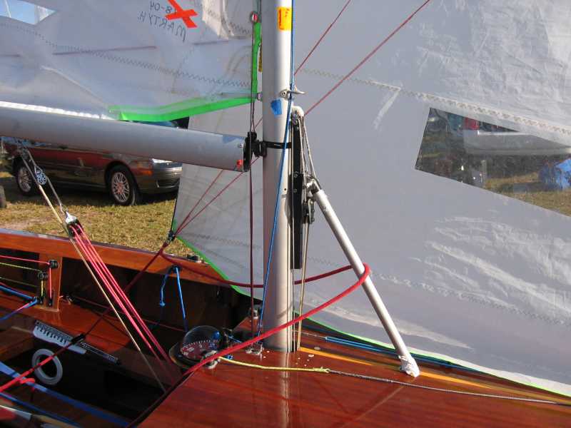

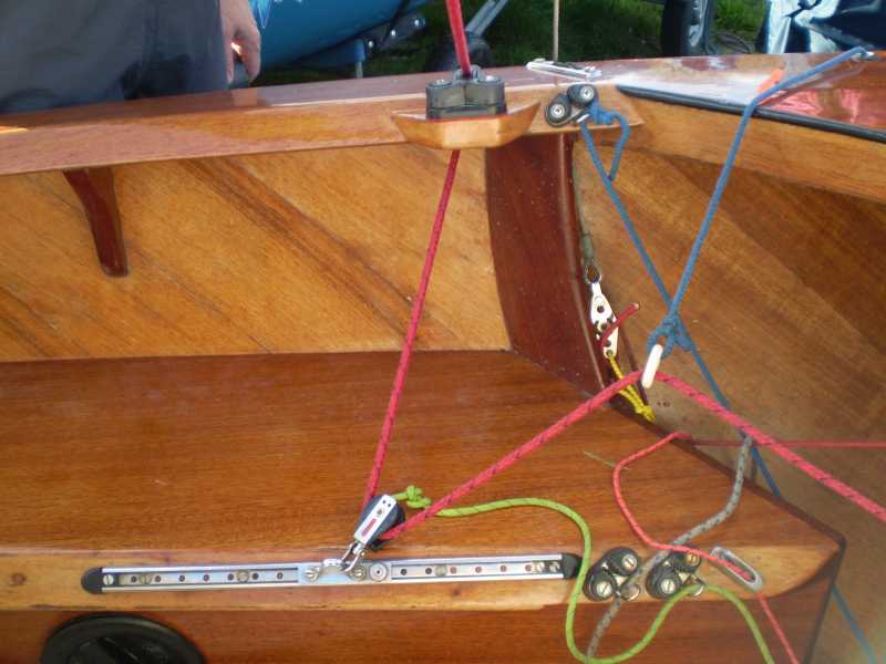

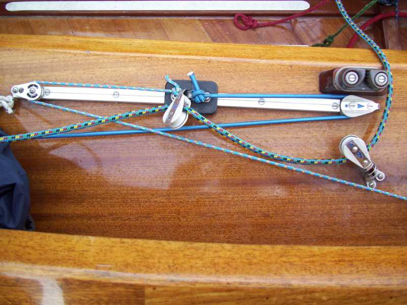

Richard...Photos show 3 options for Alb Jib sheeting arrangements... :unsure:

Thanks Mark.
My current setup is most similar to your 3rd photo, with nearly 2*180 degree turns. What I aiming for is something like your 1st photo, which to me looks like it would be a lot easier to pull.
I've now established the fact that Allen Brothers do a cleat that attaches directly to the jib car, but suspect only their jib car - need to find an example to see if I can retrofit.

We've now got a setup like no 3 in our newer boat after having the old cars with cleats. My helm thinks it's all too much as the sheets don't ease in light weather (so I had to use just one block and no cleats) but the next item on the shopping list is some much thinner smooth jib sheets to run through it better. But how do you stop it all chafing on the mast ram as you tack?

The photographs that Mark Fowler put up are very good. The middle of the 3 photos is Barney's wooden woof 6701. It is set up the same way as almost every North American boat. The jib sheet goes through a single turning ratchet block typically a 55-60 mm ratchet from Harken or Ronstan, then is lead across the boat to a cleat on the opposite side where the crew is sitting. In light winds you can use the cleat on either side.
This system is much easier to pull in. The better the block you use the easier it is to hold the jib sheet without cleating as the better ones typically have more holding power due to better friction against the rope.
