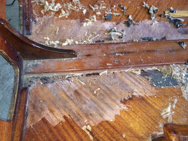

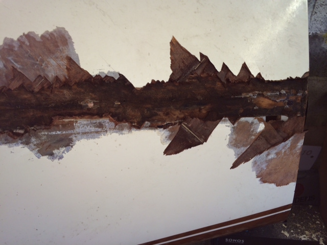

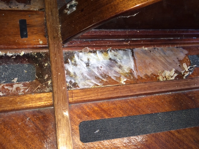

Hi all another casualty in for repair, seems to be a problem with a lot of Young built boats this is the 5th one I have repaired, a warning to any owners if you see any blackness along the hog, take immediate action it seems to stem from the centreboard case to hull joint. If anyone needs any advice please feel free to contact me.
