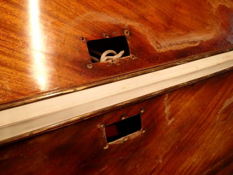

On my boat, the water ingress had caused some staining and blackening of the varnish around the hole, so the varnish was stripped back and the wood treated with oxalic acid after drying out. The varnish was then built back up in thin layers until it matched the original level and was blended back in. The photo (assuming it attaches!) shows the bailers out and oxalic acid being applied to remove the staining.
